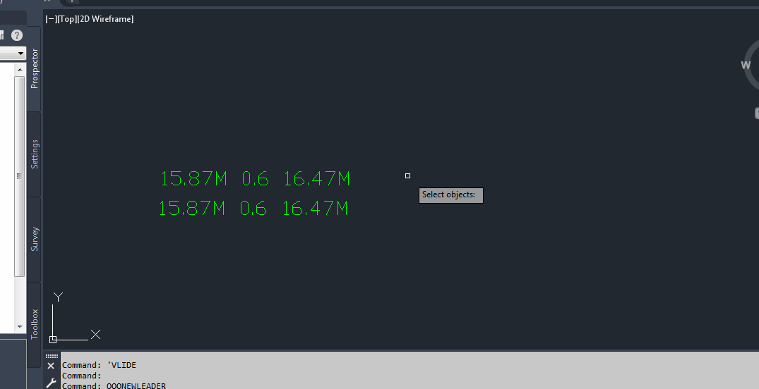

  1. SEE (defun c:QQQnewleader ( / C EXYZ NEWLEADER PTEN PTS_SS SS_LEN ) (setq pts_ss (ssget (list (cons 0 "*TEXT")))) (setq ss_len (sslength pts_ss)) (setq c 0) (while (< c ss_len) (progn (setq pten (ssname pts_ss c)) (setq exyz (cdr (ASSOC 10 (ENTGET pten)))) (command "._MLEADER" exyz (list (+ 0.5 (car exyz)) (+ 0.2 (cadr exyz)) (caddr exyz)) "") (setq newleader (vlax-ename->vla-object (entlast))) (vla-put-textstring newleader (cdr (ASSOC 1 (ENTGET pten)))) (setq c (+ c 1)) ) ) (princ) )
