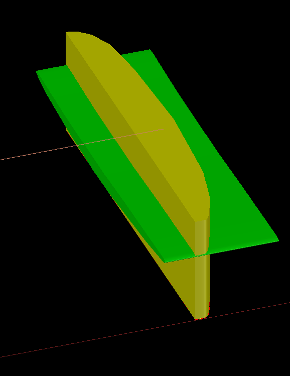

  7. Start with two views of the paddleboard and create a region from a spline for half of the top (or bottom) view and the full side view. Extrude the two regions and rotate the profile solid so that it intersects the extruded top view. Execute a Boolean intersect. to get half of the board then mirror and union to get a single solid of the board.
