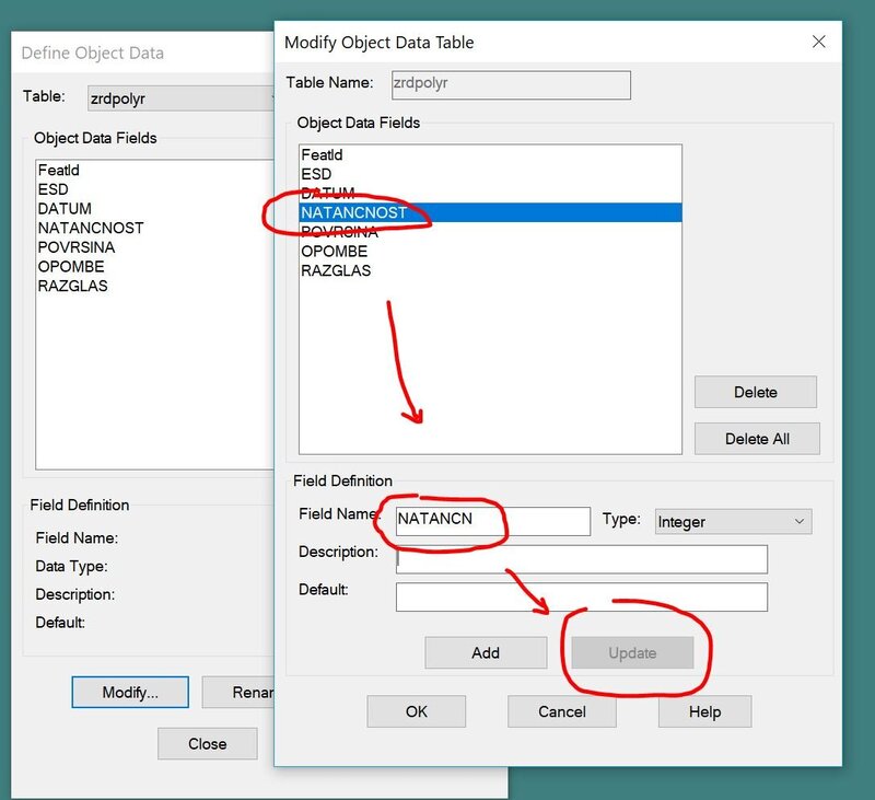

  5. In my drawing, using Autocad Map 3d 2021, I cannot rename Object Data Field Name. In "Define Object Data" I normally select my Table, then click "Modify", then I select Object data field in which I wish to rename its Field name. But when I change Field Name, button "Update" is inactive...it's colour remains gray and cannot click on it. It is possible to rename Description but not Field Name! Why? Is it possible at all?
