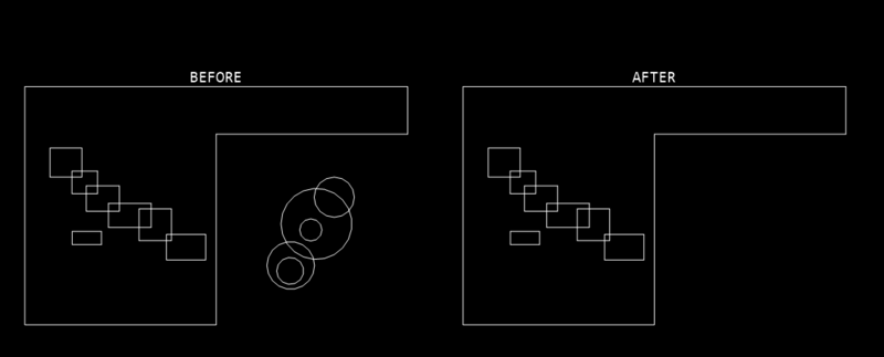

  2. this will allow you to select inside your polyline then delete stuff thats still within the min max of the polyline not completely inside. ;;----------------------------------------------------------------------------;; ;; ssget "WP" doesn't work well with arc this fixes it (defun SELECTINSIDE (ent acc / i j l) (setq i (/ (vlax-curve-getdistatparam ent (vlax-curve-getendparam ent)) acc) j (- i) ) (repeat (fix acc) (setq l (cons (trans (vlax-curve-getpointatdist ent (setq j (+ j i))) 0 1) l)) ) (setq SS1 (ssget "_WP" l)) ) (SELECTINSIDE poly 100) (setq SS (ssget "_W" minExt maxExt)) (ssdel poly ss) (foreach e (vl-remove-if 'listp (mapcar 'cadr (ssnamex ss1))) (ssdel e SS) ) (foreach e (vl-remove-if 'listp (mapcar 'cadr (ssnamex ss))) (entdel e) )
