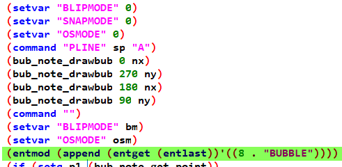

  2. Add this line and you don't have to worry about the current layer changing:

  3. BUB-NOTE.LSPI downloaded it and added an option for Caligraphy Style in Sept'03. Haven't used it in many years.

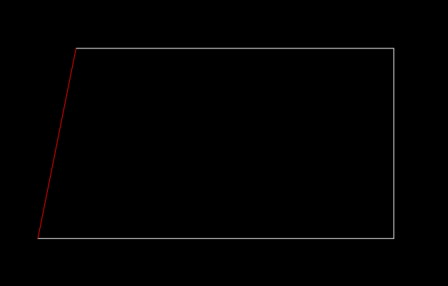

  4. like i said its adjustable. It all depends on how accurate you wanted it. Yes you put in precision distances. when its running the code its finding a difference of 2.27373675443232e-013 witch is 0.0000000000002273 a very small number but its still greater then 0. so it changes the entity red. if you update Ronjon's code to have a tolerance (if (and (> (- (setq l (_getlength e)) (fix l)) 0.001) (< (- l (fix l)) 0.999)) or my code (if (and (> (- len flen) 0.001) (< (- len flen) 0.999)) this is what you will get
