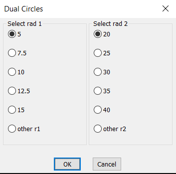

  5. You want something like this "multi radio button2.lsp" and I use lee-mac dynamic block lisp. You can have up to about 20 values per column dont have to have same amount per column.Multi radio buttons 2col.lsp if (not ah:buttscol)(load "Multi Radio buttons 2col.lsp")) (if (= ah:but nil)(setq ah:but 1)) (if (= ah:but2 nil)(setq ah:but2 1)) (setq lst1 (list "Select rad 1" "5" "7.5" "10" "12.5" "15" "other r1")) (setq lst2 (list "Select rad 2" "20" "25" "30" "35" "40" "other r2")) (ah:buttscol ah:but ah:but2 "Dual Circles" lst1 lst2) (setq ans1 (nth ah:2col ah:butlst)) (setq ans2 (nth ah:2col2 ah:butlst2))
