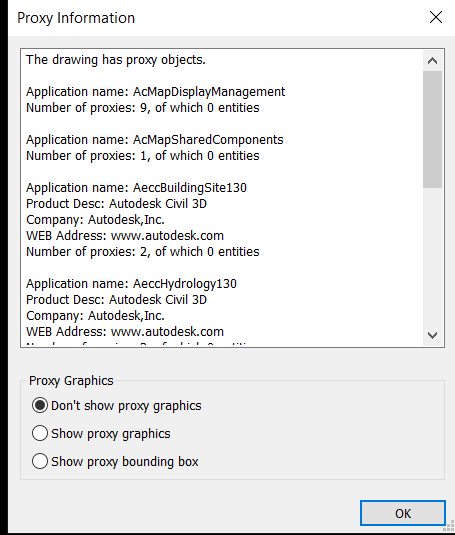

  2. If you have the proxy enablers for products then you dont get any messages, say Bricscad recognises made in CIV3D. I tried to find proxy objects at one stage and did not get far may be a answer out there.
    1 point

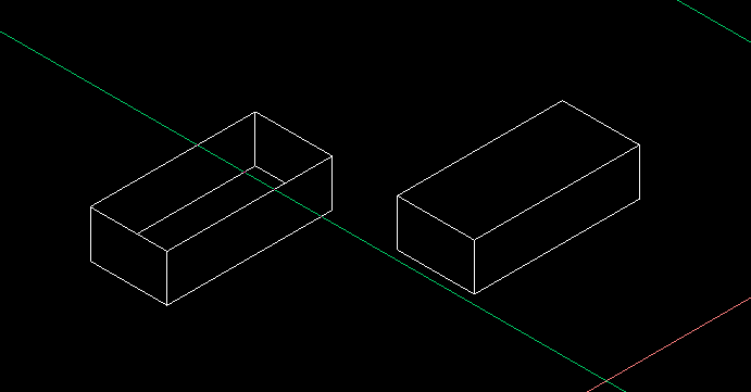

  3. Depending on what it is your drawing if its basic pline extruded and not a number of solids Unioned then there may be a way, its what I call 2.5D you make a pline and set the property thickness to what you want it will appear hollow but you can use Pface to put a top on it. The object on right has a pface and I have used HIDE
    1 point
