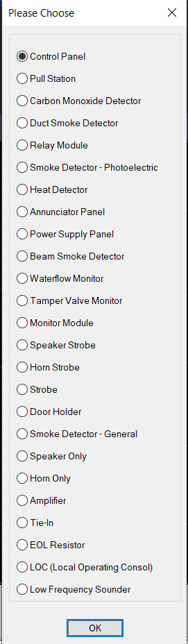

  3. For Bsmiths you need to add the attributes to the visibilty state for the horn, that way makes it way easier to get the Draw. You can using lisp to pop the visibilty states when inserting the block rather than having to click on the arrow to choose, it uses Lee-mac dynamic block lisp to read the states, then populate the Multi radio. If you edit the block can provide for you.
    1 point
  4. I just replace all Initget now with the multi radio just feel easier to pick off screen for user input. No need for code to exist in your code. As the buttons are only choice can not enter anything else. (if (not AH:Butts)(load "Multi Radio buttons.lsp")) (if (= but nil)(setq but 1)) (setq mywiresize (atof (ah:butts but "V" '("Enter Wire Gauge" " 12" " 14" " 16" " 18" " 22" )))) (setq but 1) ; needed if calling multi radio again later in program can set to next desired button number (setq Nextdevice (ah:butts but "h" '("Select another device" "YES" "NO"))) (setq but 1) Did find a mistake in code for horizontal as per yes no so change multi radio buttons for horizontal. Was missing check width of heading. (if (= (strcase verhor) "V") (progn (write-line " : boxed_radio_column {" fo) (write-line (strcat " width = " (rtos (+ (strlen (nth 0 butlst)) 10) 2 0) " ;") fo) ; increase 10 if label does not appear ) (progn (write-line " : boxed_radio_row {" fo) (write-line (strcat " width = " (rtos (+ (strlen (nth 0 butlst)) 10) 2 0) " ;") fo) ; increase 10 if label does not appear ) )
