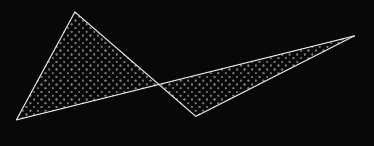

  2. Sure would .. I've come to like the shorter format whether right or wrong. I see you've removed the type test .. that will not work. Try something like: (if (setq a (vl-catch-all-error-p (vl-catch-all-apply 'vla-get-area (list (vlax-ename->vla-object ent)))) ) (setq bad (cons ent bad)) (setq area (+ area a) good (cons ent good) ) ) Create a self intersecting area then hatch by object to test:
