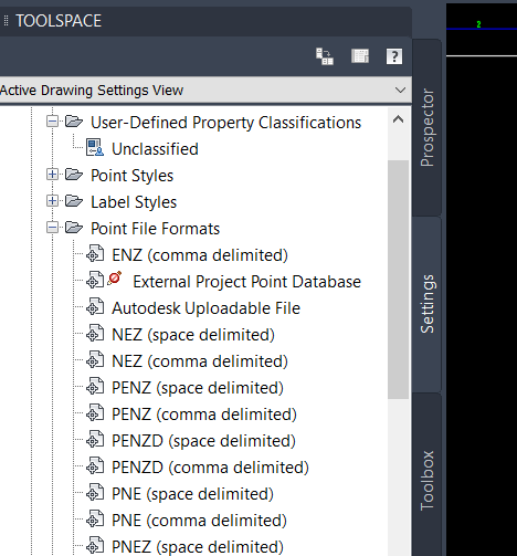

  3. Yeah Civ3D is a pain type toolspace. So you can see no Lat long you actually have to go in and add it as a style, and set your world zone, then its easy.

  5. The quickest way is to use CIV3D which supports lat long input, I have downloaded photos from a phone, with tracking on they store the gps co-ord in the jpg used ghostscript to pull it out then placed all the photos on a survey plan. If you know someone that has CIV3d it would be like 2-3 minutes to download, make a dwg and re-email back. I am in wrong time zone for you or could do. I found the excel straight away google "Projection and Transformation Calculations" what was very interesting was that the VBA code is exposed, most times with this sort of thing its password protected. So you could edit the sheet and make it do multiple lat longs. you could then do a column answer with pline as top line and cut and paste to autocad. I am not real good at VBA but some one else may do it for you.
