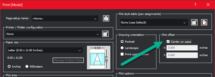

  8. You have hard clip limits set LL & UR I would use those with a Plot Window Center. This should work every time. inside your printer/plotter ie the actual printer not pc often the firmware limits can be set and an option can be to change margins, the firmware will override the plot output.
