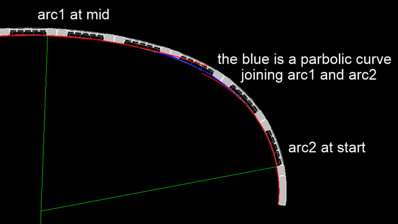

  4. My $0.05 I did look at road vertical curve it takes into account, start point and grade at that point ie tangential, end point again grade at that point, I have a paper copy of the formula looking for jpg for y=x something then can see if can replicate. But looking at shape maybe this, but note it has a R value which controls the 2 parabola curve answer. I think that is what has been used. http://onlinepubs.trb.org/Onlinepubs/trr/1994/1445/1445-010.pdf

  5. It may have started life as 3 arcs then been splines in some way or as in road designs as suggested some form of parabolic spiral added between the 3 arcs. They are not giving the formula used to create. When construction started this was same problem how to build these concrete shells with changing radius.

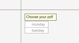

  9. Keyword Specifications https://help.autodesk.com/view/ACD/2022/ENU/?guid=GUID-9ED8841B-5C1D-4B3F-9F3B-84A4408A6BBF The string argument is interpreted according to the following rules: Each keyword is separated from the following keyword by one or more spaces. For example, "Width Height Depth" defines three keywords. Each keyword can contain only letters, numbers, and hyphens (-). You're trying to use filenames with a period in them. Try using (initget "monday tuesday") (setq Request (getkword "Choose your pdf [monday/tuesday] ") Request (strcat Request ".pdf")
