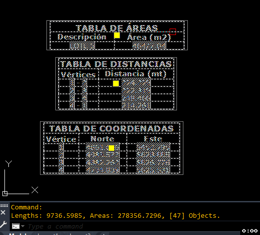

  3. You're welcome anytime. Here is a new one with a few mods for a better performance and alert. (defun c:Test (/ ssn int sel ent ins lst) ;; Tharwat - 28.Jul.2021 ;; (and (princ "\nSelect Main Text : ") (or (setq sel (ssget "_+.:S" '((0 . "*TEXT")))) (alert "Nothing selected on invalid object. Try again") ) (setq ssn (ssname sel 0) ins (Text:Pt_ (entget ssn)) ) (setq int -1 sel (ssget "_X" (list '(0 . "*TEXT") (cons 410 (getvar 'CTAB)))) ) (progn (while (setq int (1+ int) ent (ssname sel int) ) (or (equal ssn ent) (setq lst (cons (list (Text:Pt_ (entget ent)) ent) lst) ) ) ) lst ) (or (< 1 (length lst)) (alert "Number of text is less than two <!>") ) (sssetfirst nil (ssadd (cadr (cadr (vl-sort lst '(lambda (j k) (< (distance ins (car j)) (distance ins (car k))) ) ) ) ) ) ) ) (princ) ) (vl-load-com) (defun Text:Pt_ (get_) (cdr (assoc (if (or (eq "MTEXT" (cdr (assoc 0 get_))) (and (zerop (cdr (assoc 72 get_))) (zerop (cdr (assoc 73 get_))) ) ) 10 11 ) get_ ) ) )
    1 point
  4. Here is my program that I wrote a few months back to help me to strip Fields in Attributed blocks and I modified it for you to work on texts in groups. Fld2Txt.VLX
