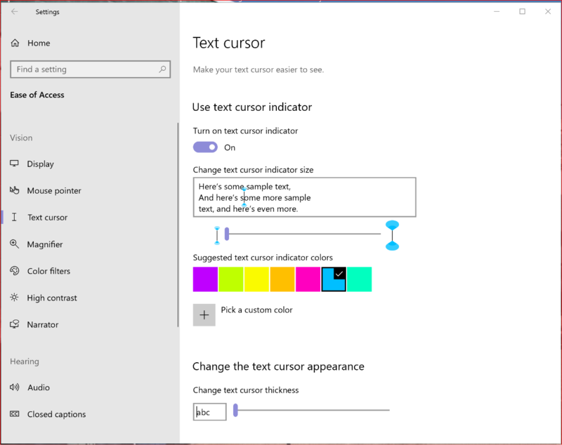

  2. Always happy to help, as you have me, getting used to ProSteel. I really like this feature, Ease Of Access settings in Windows 10
