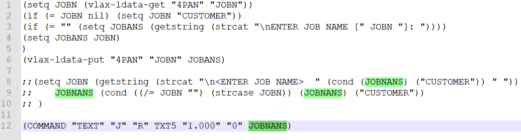

  1. In all honesty didn't see it until i pasted it into notepad++. its a better notepad and you can get a lisp plug in for it. also look into Visual Studio its has even more featurs then notepad++ but can be a bit overwhelming. If your inputting the same customer I suggest use the second code. It will save and remember the last input between drawings. (or (setq JOBN (getenv "4PAN")) (setq JOBN "CUSTOMER")) ;looks for JOBN in registry if not found sets it to Customer (if (= "" (setq a (getstring (strcat "\nENTER JOB NAME [" JOBN "]: ")))) (setq a JOBN) ;if you hit enter it will set a to dia value else override it to what you input ) (setenv "4PAN" JOBN)

  2. Guessing you looked at this? The only thing wrong is calling the wrong variable. you have an extra N in the text command. either change that or the ldata to match (COMMAND "TEXT" "J" "R" TXT5 "1.000" "0" JOBNANS) ;needs to be JOBANS Its good practice to use "_non" in front point values (txt5) so if you have snaps on it could jump to something near.
