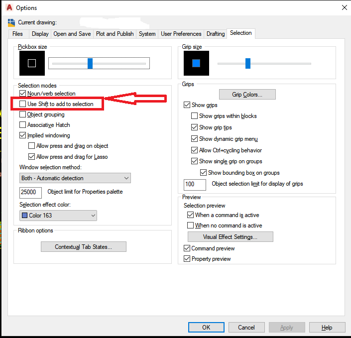

  1. Click on your username up there on the right side. then click on Account settings. Then notification settings. It's in there somewhere. Uncheck whatever this box is in Italian. Then you should be able to add objects just by clicking on them whether or not a command is active.
    1 point

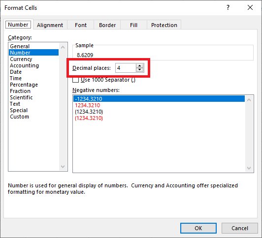

  2. Like tombu said you need to change the precision of rtos to 4 (list (rtos (/ (* (Caddr itm) 180.0) pi) 2 4)) Also In Excel In the Format Cells dialog, under Number tab their is a place to select how many decimals you want to show.
    1 point
