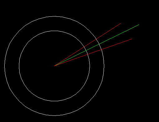

  2. I dont do a lot in 3d but you probably need to look at how you would make a gear, you will need to make 1 tooth work out the pitch, array then union them all. Others will jump in I am sure. Ps need to look at your gear tooth as the inside and outside lengths are different the matching gear has the same pattern. A tricky shape. The red lines are the bottom the green the top of the tooth. Beyond my average 3d stuff. Cutter
    1 point

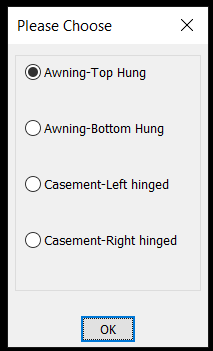

  8. This is using my library routine Multi Radio Buttons.lsp, the main routine reads the visibility states of the block uisng Lee's code then they are displayed, it will accept up to about 20 states. If you post a block will see what I can do.
    1 point
