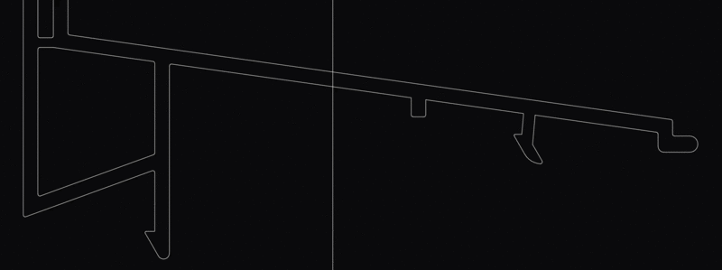

  1. Maybe this will give you some ideas: (defun c:foo (/ a b c d e i l mp o p p2 s) (setq d 0.075) (if (setq s (ssget "_X" '((0 . "LWPOLYLINE")))) (progn (setq s (mapcar 'cadr (ssnamex s))) (while (setq p (getpoint "\nPick a point:")) (setq a (mapcar '(lambda (e) (list (setq p2 (vlax-curve-getclosestpointto e p)) (distance p p2) e)) s ) ) (setq a (vl-sort a '(lambda (r j) (< (cadr r) (cadr j))))) (cond ((< (cadar a) d) (setq o (vlax-ename->vla-object (last (car a)))) (mapcar 'set '(b c) (mapcar 'car a)) (setq mp (mapcar '/ (mapcar '+ b c) '(2 2 2))) (setq l (entmakex (list '(0 . "LINE") (cons 10 (polar p (angle p b) d)) (cons 11 (polar p (angle b p) d)) '(8 . "templayer") ) ) ) (setq i (vlax-invoke o 'intersectwith (vlax-ename->vla-object l) 0)) (entdel l) (if (= 6 (length i)) (setq b (mapcar '+ i '(0 0 0)) c (mapcar '+ (cdddr i) '(0 0 0)) mp (mapcar '/ (mapcar '+ b c) '(2 2 2)) ) ) (entmakex (list '(0 . "CIRCLE") (cons 10 mp) (cons 40 (/ (distance b c) 2)) '(62 . 3))) ) ) ) ) ) ) (vl-load-com)
