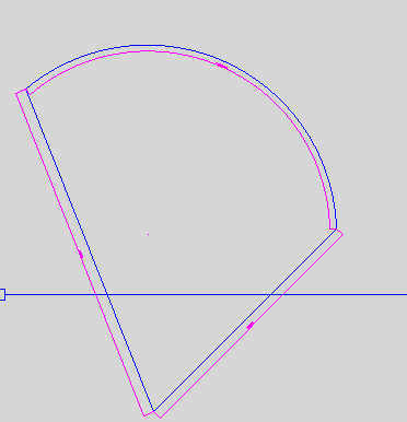

  1. What do I mean, is some like this sample . it is a real true sample dim arced polylines.dwg
    1 point
  2. I got it , to set the arc dim is easy , any way, inside or outside , for lines it is problem, I know it is a pollyne. As to test in your case , please upload a real - true- as yor use, a sample dwg , not so simple as the screenshot yo show us And if yo admit the dim to be any way located
    1 point
  3. Did you google pretty sure it would be out there. Like dan20047 need to look at points (10 and is bulge (42
    1 point
