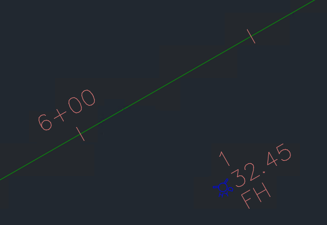

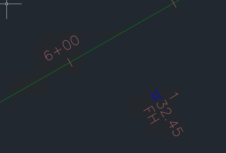

  4. @bsimpson - to me, this routine does rotate the point so that it is parallel to the alignment.
    1 point
