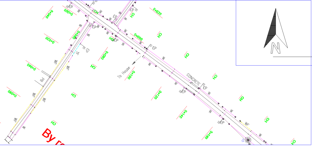

  4. Hi @BIGAL Your Lisp working well. According @Ish requirement is here (defun c:dd (/ sss obj ang ss vpo) (command "._PSPACE") (prompt "\nSelect source Viewport") (setq sss (ssget "_+.:E:S" (list (cons 0 "Viewport")) )) (setq obj (vlax-ename->vla-object (ssname sss 0))) (if (= (vla-get-objectname obj) "AcDbViewport") (setq ang (vlax-get obj 'TwistAngle)) ) (prompt "\nSelect North symbol Vewport") (setq ss (ssget "_+.:E:S" (list (cons 0 "Viewport")))) (setq vpo (vlax-ename->vla-object (ssname ss 0))) (vlax-put-property vpo 'TwistAngle ang) ) Original Result TwistAngle on Viewport.lsp
    1 point
  5. Here is a more than you asked for but shows the properties of a viewport you could pick north point and get angle, you may need to set angdir 1st else will possibly get wrong angle. You should be able to put twistangle not tested. (command "._PSPACE") (setq sss (ssget "_+.:E:S" (list (cons 0 "Viewport")))) (setq cspace (cdr (assoc 69 (entget (ssname sss 0))))) (setq obj (vlax-ename->vla-object (ssname sss 0))) (if (= (vla-get-objectname obj) "AcDbViewport") (progn (setq cen (vlax-get obj 'Center )) (setq ht (vlax-get obj 'Height)) (setq wid (vlax-get obj 'Width)) (setq sc (vlax-get obj 'customscale )) (setq ang (vlax-get obj 'TwistAngle)) )) I have the other rotate block to match a viewpoint angle.
    1 point
