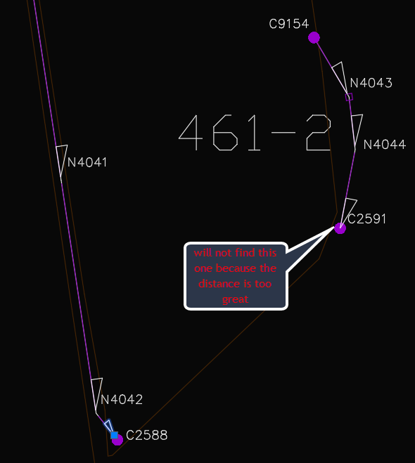

  3. It mostly works on the Pipe_Network drawing.
    1 point
