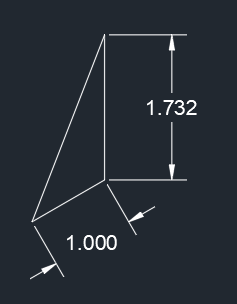

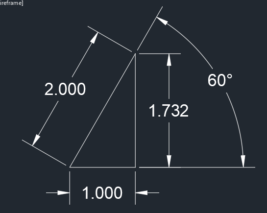

  5. @Cadbuddy when creating an isometric drawing you cannot use the "real" angles to draw lines at an angle. Consider the following. A cube that has side lengths of 1 would look like the image below. The red and green lines are diagonals on one face of the cube. We know that for the real object these lines would be at an angle of 45° relative to the cube's edge. Look at the real measure angles. For the red "45°" line we measure 1 unit up to the right and then 1 unit straight up. For the green "45°" line we measure 1 unit down and then 1 unit up to the right. We know that a 30-60 triangle has sides of 1 and 1.732 (square root of 3) and a diagonal of 2. To draw the 60° line in your isometric measure 1 unit at an angle of 30° then up 1.732 as follow. Trim the resulting line as necessary.
