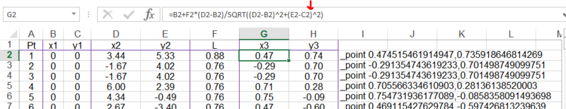

  6. @jay@sitetechnologies.io I had a typo in my spreadsheet. Here it is corrected in your Excel file. A similar correction is required in H2 before you fill down. =C2+F2*(E2-C2)/SQRT((D2-B2)^2+(E2-C2)^2) You can copy and pasted the AutoCAD commands in column into the AutoCAD prompt llne to create the points. SolvingPointC.01.xlsx

  7. If want an excel solution could use a ratio answer have pta 0,0 & ptb x,y so work out length pta to ptb then desired length/ total length. Something about an old guy pythagoras. Now (ratio * x2) (ratio * y2) then add to 0,0 thats the new point co-ordinates.
