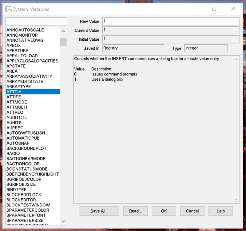

  1. @Dana W LT can provide a full list of the system variables using the 'SETVAR' command followed by '?' '*' It is easier to use if you turn on logfiles to get a saved file of the command history and you also need to set 'QAFLAGS=2' to stop the command window from prompting you to press enter affter each screen full of results. I use this often to trace down odd behaviour and quickly check various values (relatively quickly ) you do need to find the logfile and scroll through to the relevant part. It is often easier to close a drawing first and reopen it to start a fresh logfile.

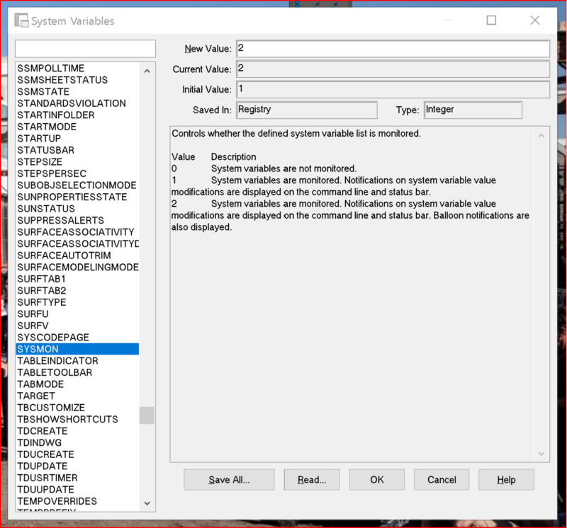

  7. SYSMON is active in 2021 LT, F1 help says the documentation on it is from 2020 so it may not be in 2015 EDIT ADDED - SYSVARMON and SYSMON were new in the 2016 release. 2021 still does not have the command for listing all SYSVAR's

  8. Glad you figured it out, and that you posted back with your solution. I spent a little while yesterday trying to figure it out. I have never used LT, so I am not sure if SYSMON is available to you or not?
