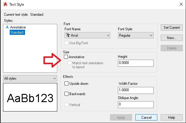

  1. If you change your text style to annotative there is then the tick-box that will keep text always facing the right way.
    1 point
