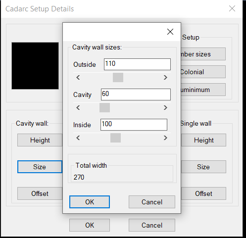

  3. You can have child dcl ie pick a button and a new dcl will open over the top of the existing.
    1 point
