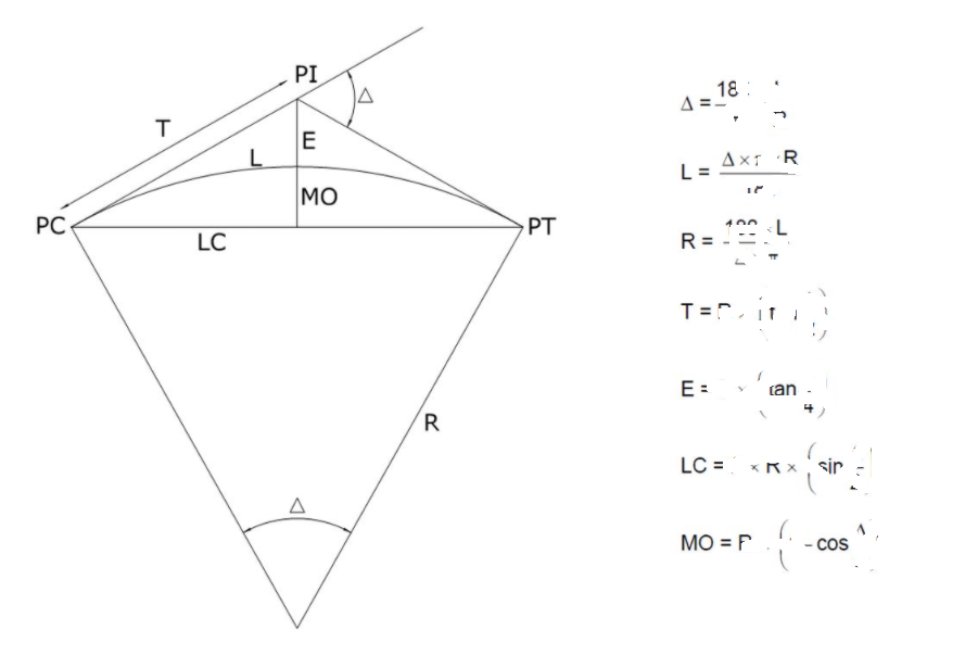

  2. Just get your engineering or surveying handbook out and look up horizontal curve you will find a diagram that has all the variables and how to work out the answers, just draw it and think about old school sin cos pythagoras etc. This was like 1 minute on Google
    1 point
