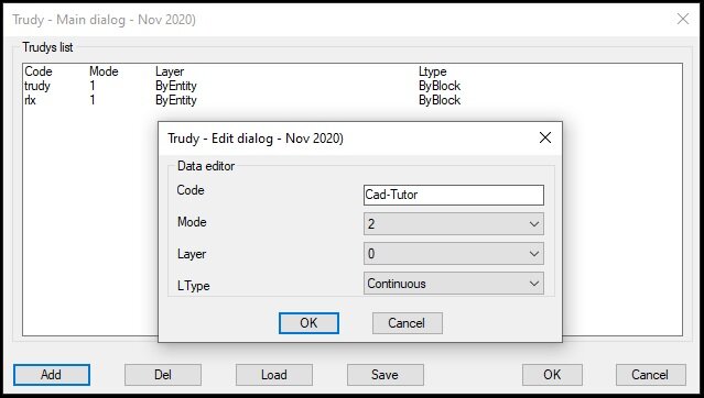

  5. just to get you started. I've updated it a little bit this weekend so buttons work now. What you do with the end result (trudys-list) is your party cause it don't know didly about 'geodesism' Trudy.lsp
    1 point

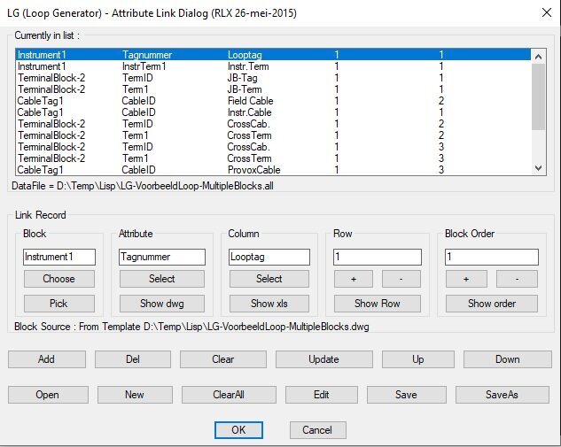

  6. Good catch pkenewell , probably simpler to implement too. Done something simular in the past.... wow , 2015, has it been five years ago already... how time flies... don't even know how this program works anymore haha
    1 point
