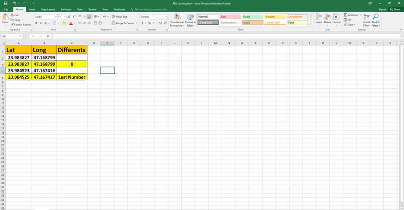

  13. Dude, Believe me, I have good knowledge about VBA, I tried to work with your solution but I failed maybe there is a misunderstanding, my requirements is a way that's can help me to compare and find the similar values like : 21,649004 39,398330 21,649005 39,398329 As you can see, the numbers are the same except for the sixth number after the comma, it is different If you can write a code to do that, please attach the excel file that's will be kind of you @PeterPan9720

  15. Does the following do what you want for removing duplicate coordinate pairs? I had the program output the results into columns E and F. The code does not do any error processing and has only been lightly tested. Option Base 1 Sub test() 'Removes Lat Long coordinates pairs that are duplicated within ' a spedified precision. 'LRM 10 / 29 / 2020 Dim LatLong(100, 2) As Variant Dim LatLongNew(100, 2) As Double Dim n As Integer, i As Integer, k As Integer, num As Integer i = 1 msg = "Please enter desired number of decimal places" & vbCrLf & _ "of desired precision." n = InputBox(msg, "Specify Precision", 6) Range("B2:B2").Select While ActiveCell.Value <> "" LatLong(i, 1) = ActiveCell.Value ActiveCell.Offset(0, 1).Select LatLong(i, 2) = ActiveCell.Value ActiveCell.Offset(1, -1).Select i = i + 1 Wend num = i - 1 k = 1 For i = 1 To num - 1 If Round(LatLong(i, 1), n) <> Round(LatLong(i + 1, 1), n) Then If Round(LatLong(i, 2), n) <> Round(LatLong(i + 1, 2), n) Then ' we don't have a duplicate LatLongNew(k, 1) = LatLong(i, 1) LatLongNew(k, 2) = LatLong(i, 2) k = k + 1 End If End If Next i ' Output results Range("E2:F101").Select Selection.ClearContents Range("e2:e2").Select For i = 1 To k - 1 ActiveCell.Value = LatLongNew(i, 1) ActiveCell.Offset(0, 1).Select ActiveCell.Value = LatLong(i, 2) ActiveCell.Offset(1, -1).Select Next i End Sub

  16. Unfortunately still does not work. @PeterPan9720

  20. I attached a picture I hope the required is clear now. @PeterPan9720
