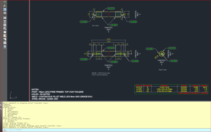

  5. As Dana suggested, and to reinforce what ReMark said. Should you find yourself working on a drawing, from or by anyone, about which you are curious, the " -DWGUNITS " command is the way to go. Ideally, one should set one's default template to reflect the measuring system and units, in which one typically works. In addition to the issue of Imperial or Metric systems of measure, is the question of what UNITS to work in. Does a value of 1 represent one lightyear, one mile, one kilometer, one yard, foot, inch, one meter, one centimeter, one millimeter...you get the picture. The answer to that question will be supplied by your UNITS value,as you follow the prompts through -DWGUNITS. Save a copy of your drawing, upon which to experiment with -DWGUNITS. Expanding your commandline history window to display about 10 lines will help a lot to understand what is going on in the command. Read the commandline prompts carefully and move slowly through the dialog. If you run the MEASUREMENT command, the commandline response of <0> means you are working in Imperial, a response of <1> indicates Metric. Once you have a completed drawing reflecting all of the values and preferences with which you typically work, use the SAVEAS command, and in the dropdown menu select .DWT, which means you are saving that as a Template, for later use. See the last screen shot. In this dialog you can choose which .DWT to use as your DEFAULT template, every time you start a new drawing, this template will be opened, UNLESS you actively override it and choose a different .DWT.

  7. If this is an employment situation, overriding or editing dimensions including the dimension scale factor, could have a detrimental effect on your employment status. There is a command, -DWINGUNITS, which can be used to reset or re-scale your entire drawing to the correct units. However, it is important to have some understanding of what the command is going to ask you and what you want it to do for you before you use it. Notice there is a leading hyphen. it is required. Perhaps before running that command, you need to undo whatever you have done to your dimension style, and/or using the command UNITS. Please understand that the command UNITS does not change your drawing units, it only changes the label YOU have given the unit. Perhaps it you upload a copy of your drawing along with telling us what units you want to use, one of us can remedy your predicament for you while explaining how to determine your units and viewport scale up front.

  8. Which AutoCAD template file did you start with? The two obvious choices are acad.dwt and acadiso.dwt? The first, and default, is used for Imperial based drawings. The second is used for Metric drawings.
