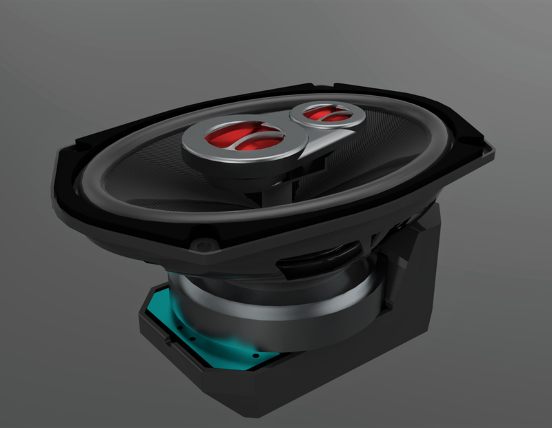

  1. Looks great! I'm always impressed by the renders that come out of this free program.

  2. I like it. My 20 year old son is in to speakers and such so I'll show him your work. He made a sub box for a friend of his that doesn't have a lot of money and we used the CNC machine at work to carve in the logos on the top. The kid almost cried when he saw it. Any way here's 5 minutes of work in Simlab Composer Lite (free) with materials and a 2 min 30 sec render.

  4. Believe or not I went searching for a 3D drawing of a 6X9" speaker on the internet and couldn't find one. So now there is a 3D drawing for a 6X9" speaker even if it's just close.

  9. After 2 days I'm close. I don't like the color but I'm learning how to edit materials.
