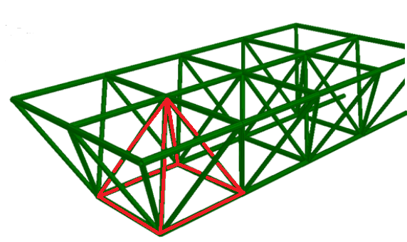

  4. The most popular configuration for a space frame is based on a pyramid cell, highlighted in red below. Is that what you seek to construct? If so create a simple single line rectangular 3D grid 60 x 60 x 36 and use it to layout your steel tubes.
