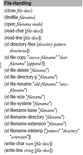

  3. Whilst this is Vlisp there should be the same function in VBA there are multiple file options like directory or dwg name only. Also (getvar 'dwgname ) (getvar 'dwgprefix)
    1 point
