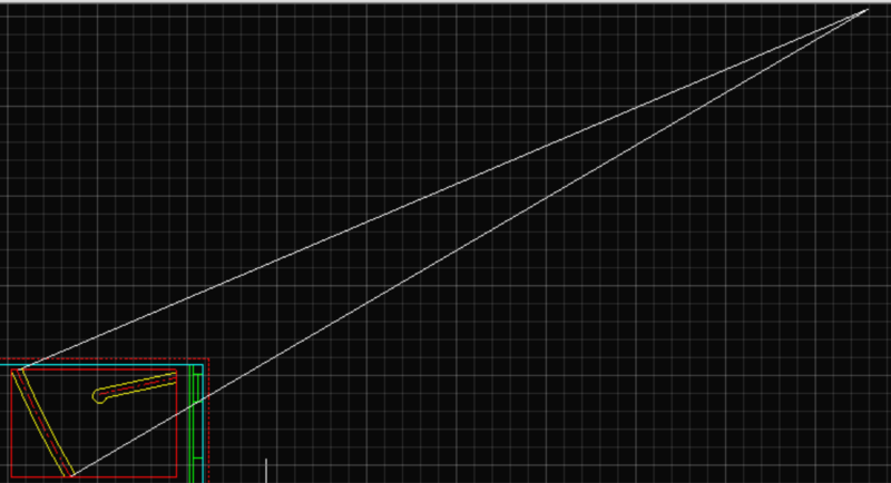

  4. OK..I found the instructions you quoted above. Yes, the centerpoint of Cedar Park Drive (a curve with a very large radius) is far outside the limits of the drawing (up and to the right) which is not all that unusual. Cedar Park Drive will cut across the left side of your drawing from top to bottom. Locate the coordinates given in your instructions and use them as the centerpoint for a CIRCLE with a radius of 7115.37. Where the circle crosses the top and bottom grid lines use the TRIM command to remove the part of the circle that is outside of the grid lines then OFFSET the portion of the circle that remains a distance of 40 units to both sides of the centerline. That will define the right-of-way. Done. This is what it looks like before the Circle trimmed.
