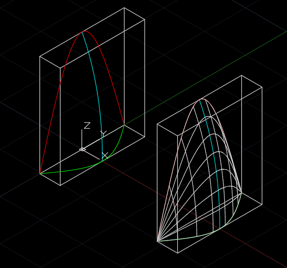

  4. In the following I used the red and green splines for lofting profiles and the cyan line as a guide create a surface, Here's the command sequence: Command: LOFT Current wire frame density: ISOLINES=4, Closed profiles creation mode = Surface Select cross sections in lofting order or [POint/Join multiple edges/MOde]: mo Closed profiles creation mode [SOlid/SUrface] <Solid>: su Select cross sections in lofting order or [POint/Join multiple edges/MOde]: 1 found <-- red spline Select cross sections in lofting order or [POint/Join multiple edges/MOde]: 1 found, 2 total <-- green spline Select cross sections in lofting order or [POint/Join multiple edges/MOde]: 2 cross sections selected <-- space Enter an option [Guides/Path/Cross sections only/Settings] <Cross sections only>: g Select guide profiles or [Join multiple edges]:1 found <-- cyan spline Select guide profiles or [Join multiple edges]: Command:
    1 point
