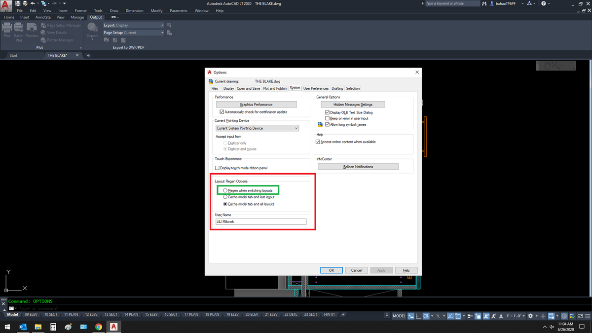

  3. OPTIONS > SYSTEM tab. Select the item in the green box shown in the attached image. My advice is not to do it though. REGEN is a hog and will take more time to change layouts. How much more time depends on what kind of hot rod video processor system you have. I personally am more than happy with REGEN on demand.
