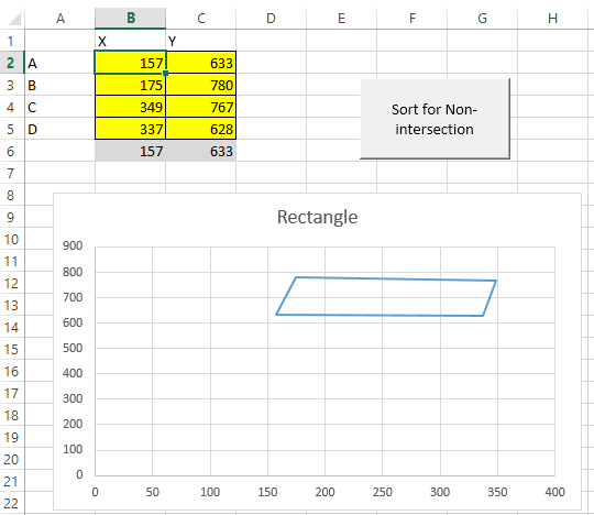

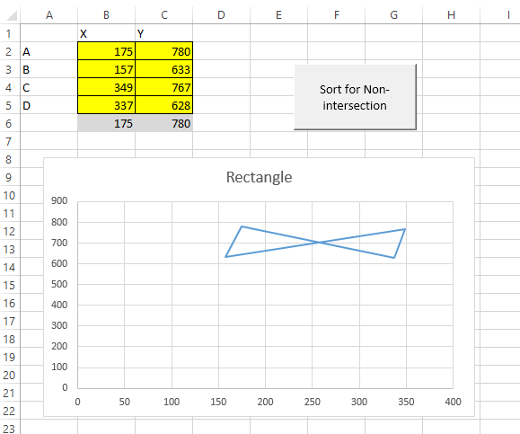

  5. The attached macro-enable Excel file will sort 4 points such that the results will not have intersecting edges. It computes the area of three different configurations and uses the configuration with the greatest area as the sorted solution. BEFORE Execution AFTER Execution INTERSECTING LINES.xlsm
