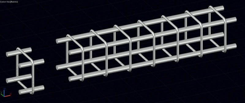

  4. As far as I know, unless something has changed in the newer versions, you can't Stretch 3D objects in a dynamic block. You can still Array them though, and the cylinders would just stack up end to end. I created a dynamic block of your object, added an Array action, and it seems to work fine. If you want fewer rings, just make your cylinders longer.
