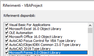

  2. Hi, I tried your code with Autocad Mechanical 2019 and Excel 2016, inside Excel VBA development area, inserting also a user form with optionbutton, making below modification it seems to run. I tried also to change line color and working fine cell color background on excel. I made some modification to variable declaration. In a first time I had some problem retrieving line Start and End points coords, later I made a modification Variable Declaration and it's running fine. I suggest to check if the object inside "ent" variable it's really a line (perhaps could be a polyline). Sheets(1).Activate Dim acadApp As Object Dim acadDoc As AcadDocument Dim currentSelectionSet As Object Dim ent As Object Dim oLine As AcadLine For your info below image with reference library in Execl Project Finally I don't understand what do you want to do with : If UserForm1.OptionButton2.Value = True Then currentSelectionSet.Select acSelectionSetPrevious, , , intGroupCode, varDataCode 'This line is a problem Else currentSelectionSet.Select acSelectionSetAll, , , intGroupCode, varDataCode 'This line is a problem Bye
