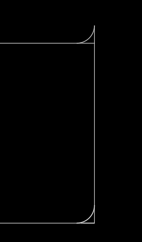

  1. hanphuc error in code (setq rad (getvar 'filletrad)) should be (setq rad (getvar 'filletrad) we all make typo's. It does not clean up the rectang was it meant to ? Makes fillet on opposite corner ? Started with plain RECTANG. Where as mine adds arc to pline. Not saying its perfect but seemed to work from the limited testing The CCW and CW is a pain to work around.
