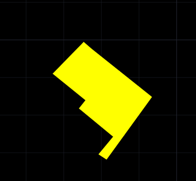

  9. Try this rework. Tested on your provided drawing. (defun c:hat (/ ss cnt obj ar tot) (setq tot 0 ss (ssget '((0 . "HATCH")))) (cond (ss (repeat (setq cnt (sslength ss)) (setq obj (vlax-ename->vla-object (setq ent (ssname ss (setq cnt (1- cnt)))))) (if (vl-catch-all-error-p (setq ar (vl-catch-all-apply 'vlax-get (list obj 'area)))) (progn (vl-cmdf "hatchgenerateboundary" ent "") (setq ar (getpropertyvalue (entlast) "area"))(entdel (entlast))) ) (setq tot (+ tot ar)) ) (alert (strcat "Total Area : "(rtos tot 2 3))) ) ) (princ) ) The hatch in question had three duplicate points at the start of the reinstated boundary polyline.

  10. FYI: BricsCAD does not have an issue determining the area of the hatch indicated by Bigal.
    1 point
  11. This is the area causing the problem no idea how to fix. You need to look at the original boundary.
