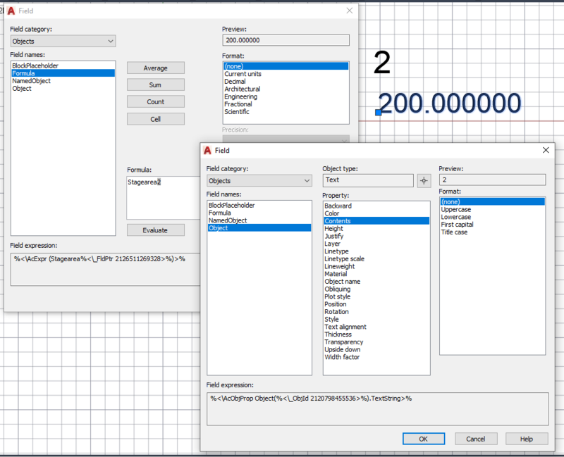

  1. AcExpr accepts lisp variable as well. Insert field, select "Formula", TYPE StageArea, insert field and point to the text content.
    1 point
