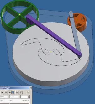

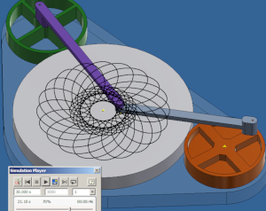

  1. I just find out that Inventor has a module for dynamic simulation. I built a simple mechanism and I started to learn by playing. I’ve got the some images like the ones I posted here before, showing the trace of the pen on the central disc. No Lisp or programming of any kind! I wish I knew this two years ago. However, I remember it was a pleasure to write those Lisp programs. Also I enjoyed discussing about it here in the forum. So, to make the short story even shorter: see here some screen captures.
    1 point
