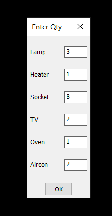

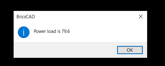

  2. Can do this add more items, Dlanorh then use your list of power items to work out load. (if (not AH:getvalsm)(load "Multi Getvals.lsp")) (setq ans (AH:getvalsm (list "Enter Qty" "Lamp " 5 4 "0" "Heater" 5 4 "0" "Socket"5 4 "0" "TV" 5 4 "0" "Oven"5 4 "0" "Aircon" 5 4 "0" ))) (setq pload 0.0) (setq pload (+ (* (atof (nth 0 ans)) 8.3) pload)) (setq pload (+ (* (atof (nth 1 ans)) 5.11) pload)) (setq pload (+ (* (atof (nth 2 ans)) 3.2) pload)) (setq pload (+ (* (atof (nth 3 ans)) 8.0) pload)) (setq pload (+ (* (atof (nth 4 ans)) 8.0) pload)) (alert (strcat "Power load is " (rtos pload 2 1)))
