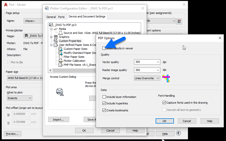

  1. I did as RonJon suggests a while back, and savd the PC3 file as something like "DWGtoPDF_NoPreview' - somethng like that - so when I run my PDF routine it uses that plotter configration but if I want to I can also plot to PDF using the standard and get the preview as required (and if you want to tak this further, my PDF routine has a pop up box where I can click 'show preview' and it selects whicever PC3 file as required)
    1 point
  2. Try unchecking this box in your PC3 file:
