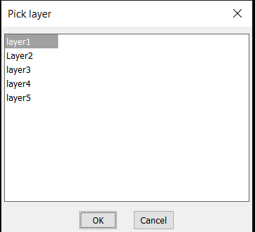

  2. If lines can use Join command 1st for this request simpler for user to do join 1st and only write code for plines. Edit for desired layer name. (defun test (/ pt1 pt2 pt3 pt4 d1 d2 ss x1 y1 x2 y2 oldsnap oldlay) (setq oldsnap (getvar 'osmode)) (setq oldlay (getvar 'clayer)) ;(setvar 'clayer your layername) change to your layer name (setq lay (cdr (assoc 8 (entget (car (entsel "pick a pline")))))) (setq ss (ssget (list (cons 0 "lwpolyline") (cons 8 lay)))) (setvar 'osmode 0) (repeat (setq x (sslength ss)) (setq co-ord '()) (setq plent (ssname ss (setq x (1- x)))) (setq co-ord (mapcar 'cdr (vl-remove-if-not '(lambda (x) (= (car x) 10)) (entget plent)))) (if (= (length co-ord) 4) (progn (setq pt1 (nth 0 co-ord)) (setq pt2 (nth 1 co-ord)) (setq pt3 (nth 2 co-ord)) (setq pt4 (nth 3 co-ord)) (setq d1 (distance pt1 pt2)) (setq d2 (distance pt2 pt3)) (If (< d1 d2) (progn (setq x1 (/ (+ (car pt1) (car pt2)) 2.0)) (setq y1 (/ (+ (cadr pt1) (cadr pt2)) 2.0)) (setq x2 (/ (+ (car pt3) (car pt4)) 2.0)) (setq y2 (/ (+ (cadr pt3) (cadr pt4)) 2.0)) (command "line" (list x1 y1) (list x2 y2) "") ) (progn (setq x1 (/ (+ (car pt2) (car pt3)) 2.0)) (setq y1 (/ (+ (cadr pt2) (cadr pt3)) 2.0)) (setq x2 (/ (+ (car pt1) (car pt4)) 2.0)) (setq y2 (/ (+ (cadr pt1) (cadr pt4)) 2.0)) (command "line" (list x1 y1) (list x2 y2) "") ) ) ) (alert " Object has less or more than 4 sides\n \n So skipped") ) ) (setvar 'osmode oldsnap) (setvar 'clayer oldlay) (princ) ) (test)
