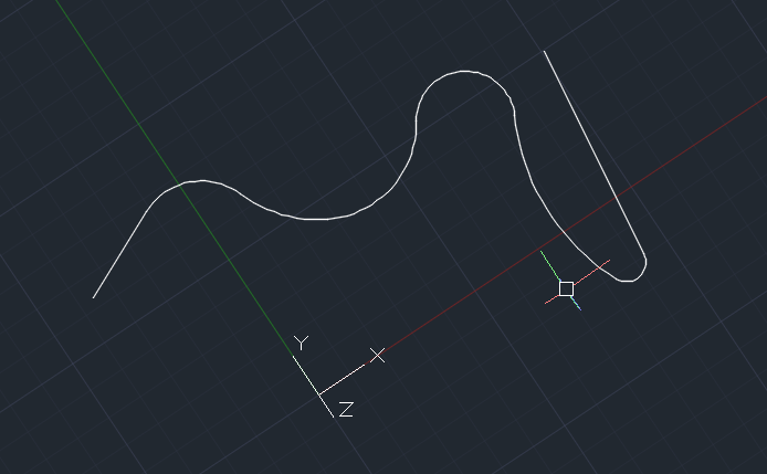

  3. I think OP wanted to learn something new... And BTW. LWPOLYLINE can have more than 2 arced segments... Perhaps OP wanted to find all quadrant points and sort them by Y of OCS of LWPOLYLINE... (defun c:minmaxYarcedsegsLW ( / LM:Bulge->Arc lw lwx k dxf10l dxf42l l v1 v2 bul b->a pl ) ;; Bulge to Arc - Lee Mac - mod by M.R. ;; p1 - start vertex ;; p2 - end vertex ;; b - bulge ;; Returns: (<center> <start angle> <end angle> <radius>) (defun LM:Bulge->Arc ( p1 p2 b / a c r ) (setq a (* 2 (atan (abs b))) r (abs (/ (distance p1 p2) 2 (sin a))) c (if (minusp b) (polar p2 (+ (- (/ pi 2) a) (angle p2 p1)) r) (polar p1 (+ (- (/ pi 2) a) (angle p1 p2)) r)) ) (list c (angle c p1) (angle c p2) r) ) (while (or (not (setq lw (car (entsel "\nPick LWPOLYLINE with arced segemnts that lie in WCS...")))) (if lw (or (/= (cdr (assoc 0 (setq lwx (entget lw)))) "LWPOLYLINE") (vl-every '(lambda ( x ) (equal (cdr x) 0.0 1e-6)) (vl-remove-if '(lambda ( x ) (/= (car x) 42)) lwx)) ) ) ) (prompt "\nMissed or picked wrong entity type or picked LWPOLYLINE with all straight segemnts...") ) (setq k -1) (setq dxf10l (vl-remove-if '(lambda ( x ) (/= (car x) 10)) lwx)) (setq dxf42l (vl-remove-if '(lambda ( x ) (/= (car x) 42)) lwx)) (while (< (setq k (1+ k)) (if (= 1 (logand 1 (cdr (assoc 70 lwx)))) (cdr (assoc 90 lwx)) (1- (cdr (assoc 90 lwx))))) (setq l (cons (list (nth k dxf10l) (nth k dxf42l)) l)) ) (setq l (reverse l)) (mapcar '(lambda ( a b ) (setq v1 (cdr (assoc 10 a)) v2 (cdr (assoc 10 b)) bul (cdr (assoc 42 a))) (if (not (equal bul 0.0 1e-6)) (progn (setq b->a (LM:Bulge->Arc v1 v2 bul)) (setq pl (cons (list (caar b->a) (+ (cadar b->a) (last b->a)) (cdr (assoc 38 lwx))) pl) pl (cons (list (caar b->a) (- (cadar b->a) (last b->a)) (cdr (assoc 38 lwx))) pl)) ) ) ) l (cdr l) ) (setq pl (mapcar '(lambda ( p ) (trans p lw 1)) pl)) (foreach p pl (if (not (equal p (osnap p "_nea") 1e-6)) (setq pl (vl-remove p pl)) ) ) (setq pl (vl-sort pl '(lambda ( a b ) (< (cadr (trans a 1 lw)) (cadr (trans b 1 lw)))))) (prompt "\nMinimum Y coordinate arced point in current UCS : ") (princ (car pl)) (prompt "\nMaximum Y coordinate arced point in current UCS : ") (princ (last pl)) (princ) ) This is all Vanilla AutoLisp, just in case VLISP functions not available...
