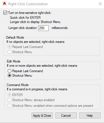

  4. Have you looked in the right click settings? These are my settings which gives you the behavior that you are seeking. If you want to change the grayed out options, uncheck the "Turn on time-sensitive right click". Check it again after changing the settings if you use it.
    1 point
