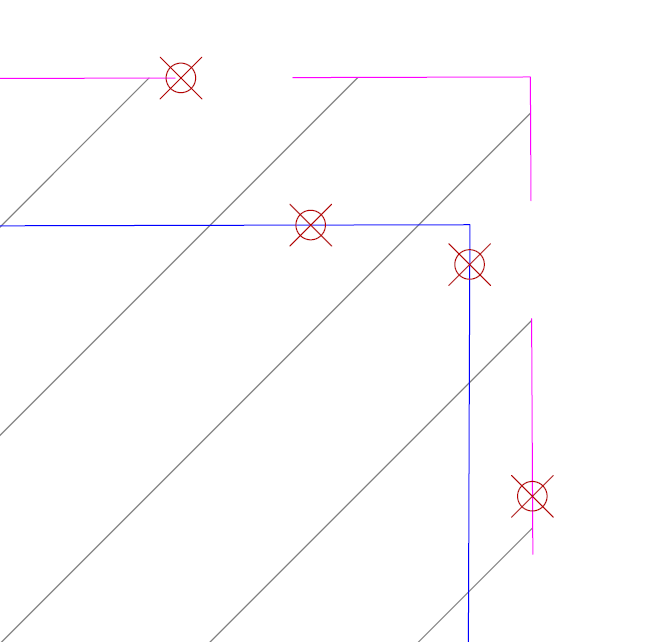

  1. I have no problem with them. They seem fine here. This is using Export This is DWG to PDF Export test dwg to pdf.pdf Export test dwg to pdf-Layout1.pdf
